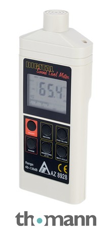

                  Sound Level Meter For monitoring SPL, Ideal for discos, live appliances and more, Ungauged, With big LC display, Selectable A/ C weighting modes, Time weighting modes: fast/slow, Measuring range between 40 dB and 130 dB, devided in 4 different...

                    ja mis kasu sellest madalamate helied mõõtmisel on ? 300 Hz bis 8K Hz (+/-2db)
