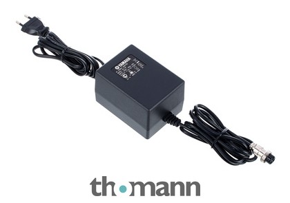

      Väljundpinge on AC 17,5 V 0.94 A
      Replacement Power Adapter Replacement power supply for Yamaha MG 12/4 FX, MG 124 CX, MW12CX, N8, Output voltage: 17.5 V ~ X2, 0.94A, Connection: 3-Pin
