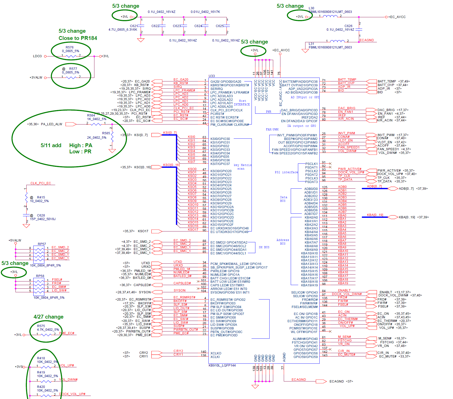

    Skeemi saab osta: (iseasi kas raatsib/tasub)
    nt. http://notebookschematic.com/?tag=hel81-schematic
    Ilma proseta masin ei tohiks sisse lülituda.
    EC otsad:
    Sisselülitamisnupp on vist 2 jala peal.
    Kui saad, siis mõõda, kas tarbimine muutub nupule vajutades?
    FL80 service manualist:
    Interface between Power with M/B
    • DC/DC
    Signals I/O Voltage Level Description
    SUSP# I 0~3.3V Low Active, system suspend control signal
    51ON# I 0~floating Low Active, POWER ON control signal.
    FSTCHG I 0~3.3V High Active, ENE910 use this pin to control the fast charge of charge
    ACOFF I 0~3.3V High Active, turn off the Adaptor power for battery automatic learning cycle
    ACIN O 0~3.3V High Active, provide to ENE910 to mean the Adaptor power is present
    VGATE O 0~3.3V High Active, it will go high when +CPU_CORE is ready
    VR_ON I 0~3.3V High Active, turn on/off the +CPU_VIDP
    BATT_TEMP O 0~3.3V Analog signal, ENE910 using this voltage level to calulate battery’s temperature
    IREF I 0~3.3V Analog signal, ENE910 using this voltage for setting charge current
    VID [0..6] I 0~3.3V The +CPU_CORE voltage depends on those PINs VID[6..0]
    CHGRTC O 3.3V Charge RTC-battery power source
    EC_SMB_DA,
    EC_SMB_CK I/O 0~5V Interface of Smbus, communicate between ENE910 and smart battery
    SYSON I 0~3.3V High Active, ENE910 use this pin to control the SYSON signal
    BATT_AOVP O 0~3.3V Analog signal, ENE910 using this voltage level for battery over voltage protection
