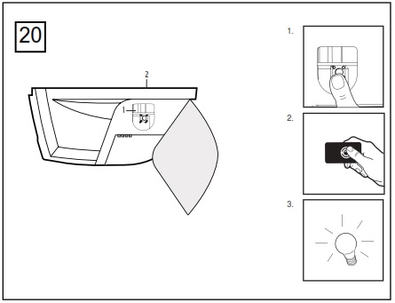

          Uurin, kuidas käib seadmele "unustatud" puldi tuvastamine, see on kirjas pdf failis punkt 20 all.
          Fail
          Sisu selline:
          Activate the opener only when door is in full view, free of obstruction and properly adjusted. No one should enter or leave garage while door is in motion.
          Your garage door opener receiver and Remote Control Transmitter are set to a matching code. If you purchase additional Remote Controls, the garage door opener must be programmed to accept the new Remote code.
          To program receiver to match additional Remote Control codes:
          1. Press and release the program button on the side of the unit (1). The green LED will glow steadily for 30 seconds.
          2. Within 30 seconds press and hold the button on the hand-held
          Remote (2).
          3. Release the button when the motor unit light blinks. It has learned the code. If the light bulb is not installed, two clicks will be hear.
          To erase all codes from motor unit memory or to deactivate any unwanted Remote, first erase all codes:
          Press and hold the program button (1) on motor unit until the learn indicator light goes out (approximately 6 seconds). All previous codes are now erased. Reprogram each Remote or Keyless Entry you wish to use.
